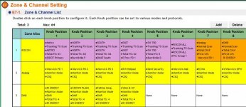

Yeah I am beginning to see the real benefit of the G5 is the P25 system. And thats what I mostly use it for. I only ordered the radio with the DMR upgrade cause I figured I might as well have some DMR freqs to listen to. I have knob position 7 programmed with 7 conventional UHF (PD, FD) and it receives and scans fine. Attached is the ZONE CHANNEL SETTING so maybe you can see what I messed up...I understand setting up 2 channels with both slot 1 and slot 2, but I wanted to keep all the DMR freqs on the same knob cause all the other knob positions are filled. I might delete all the DMR stuff since i already have other DMR radios.

I can't see what you actually have in Zone 1 positions 7 & 8 but the frequencies are obviously in there in other zones. Which one did you want to lock it on?
Wait, with DMR you can only have 1 TG per knob position as far as I know. Perhaps @RaleighGuy will pop back in here but I believe it's 1 frequency, 1 TG and 1 time slot per knob position. If that's not the case perhaps someone else will advise.
OK I re programmed the whole radio and left out the DMR for now. In Zone 1 knob 7 I have some analog PD and FD....they are at bottom row in pic. I see now to use DMR I just have to double up the entries and make each entry two times, one entry with slot one and the other entry slot 2. Analog UHF no problem, you just need 1 entry per freq. I am still not sure how to make 2 of the same freqs with 2 different time slots. I cant find where to set the time slots individually. The DMR parameters only gives you one choice and it appears to be global.
