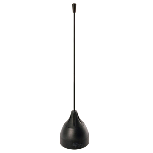

Just had a GRS antenna installed, but I’m wondering about that little gap that’s between the antenna and Honda. There is a grommet but it just seems weird that it’s kind of open.
Is this okay?

They make a gasket that will fill that in:
I have found that over time water tends to find its way down the whip/under the nut and lead to some surface corrosion with those style antennas. The gasket won't prevent it, just delay it.
Rather than buying the gaskets, do yourself a favor and get one of these antennas that will properly seal everything and prevent headaches down the road:

I added the antenna em wave. I used the small o ring. Does the outside antenna at the base bend out a bit when you hand tighten it? Just double checking.

You see at the base, when i tightened it the rubber bottom part of the antenna went out. is that correct?
Is this okay?
When I look at the first two photos, the antenna base appears ever so slightly tilted to me, suggesting that the antenna base might be cross-threaded and not completely snugged down on the roof. It might just be the camera angle, but this is something that can happen if you're not careful. It's happened to me from time to time. Couldn't hurt to check. :)
