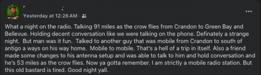

100% agree. Worst base antenna i ever owned. Fine for DX, but horribly deaf for local comms past 25+ miles. Just the other night i managed 91 miles on 38LSB to a mobile station in Crandon, WI with my Sirio GPS-27 1/2 wave with no ground pane kit. Want proof? I found his fbook post. I’m the Green Bay/Bellevue station. It’s attached below.
