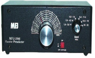

Definitely aware of an SDR dongle's tendency to overload and show what looks like a repeating signal/RFI across a chunk of spectrum (Like my AirSpy was doing with my golf cart's speed controller on my RFI patrol cruise around the neighborhood). I would have brought the Kenwood TS-890S Superhet but it's 34lbs and kinda $$$. :)
You could add something like this. In the 70's Kenwood and others made outboard band pass preselectors you can still find on ebay that would complement an SDR.
