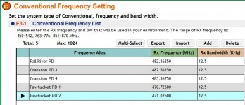

I want to include a few local stand alone conventional PD freqs. But I am having trouble with the "Conventional group ID settings" and "TGID grouping list"......attached is what I have so far in the CPS. I am sure the data is correct in the first two bottom pics. The problem is I dont know what the talk groups are for these users. There is nothing listed in RR for conventional P25 talk groups. Here are the 5 channels I want to set:
(Mass.) Fall River PD 1 482.3625 NAC 676
(RI) Cranston PD 3 482.5625 NAC DEF
(RI) Cranston PD car-tocar 483.6375 NAC DEF
(RI) Pawtucket PD 1 470.725 NAC 293
(RI) Pawtucket PD 2 471.075 NAC 293
I dont understand how to get any further. attached is the GROUP PARAMETER, which I dont understand. I dont use any alert tones or sounds. When I try to set the "TGID group list, I get error saying both Cranston and Pawtucket, since they each both have the same "NAC" it says they each both have the have the same TGID's???? I only can enter the NAC.....there are no talk groups I can see for these users. So until I can get past this point I am stuck!

You don't set up new protocols, all of them use the P25 Conventional protocol. You program them in the zone/knob position you want (one freq per knob). If you don't know TGs use the monitor setting with 65535 wildcard, set up in E-6.1 and E-6.2.

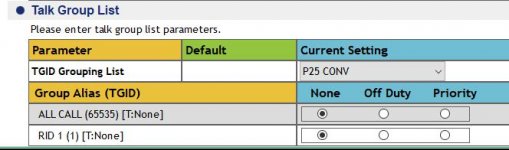

I am still not understanding, sorry. Did I do this right? I click on each entry in the E-6.1 and make the TGID wildcard. But when I try to go further I get this error. I remember this problem before but can't remember how to fix. And I keep getting error complaining that all entries have the same TG. I go to "Conventional group ID settings" and get this error, error2 in picture. So I am going around in circles.

You list the wildcard 65535 ONE TIME in E-6.1, you then go to E-6.2 and create ONE group, call it "conventional" "wildcard" whatever u want and that is what you use as the TGID Grouping List current setting. This same one would be used for all entries, you do not need separate ones for each group if you are only using 65535.

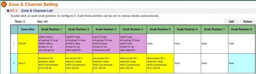

OK I think I got it right but I cant get to the place where you add the freqs to the scan list for a knob position. I want to assign these 5 P25 conv. channels all into zone 1 knob 5. Is it because they are all set to "Monitor"? OK Changed to normal scan and I think it is working.
Normal scan would be correct. Once you pick that you can select which channels to scan.
