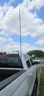

Getting high swr with firestick, what can I do?
Would moving the antenna side of the bed where it's not behind the cab or putting it at the tail gate?

Can't tell from the picture if there is a bed liner on there or not. I'm betting the mount isn't properly grounded to the bed. If it is then it's likely it just needs to be tuned. Is this a Firestik II with a tunable tip? If not, then likely some cutting will be involved.
That’s my guess, as well. Luckily, it’s also an antenna of decent length.
