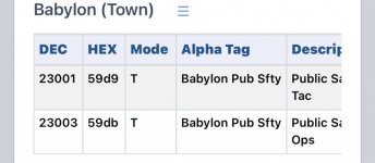

Thanks , I am receiving a T mode , the Town of Babylon Public Safety Dept. , I’ve been listening to them since I updated it the other day.

If you are receiving those talkgroups, they are Phase 1. Depending how the system is programmed, a Phase 2 talkgroup may revert to Phase 1 if a Phase 1 radio affiliates with the talkgroup. The database shows a talkgroup to be Phase 2 if a Phase 2 transmission has been observed.
enosjones
Feb 22, 2006
2,168
255
Price, Utah
It is possible that the control channel is phase 1, even though the system is phase 2. Mine is doing the same thing for the system here in Utah. They alternate between phase 1 and 2. Especially if the talkgroups are patched with either vhf or some other way it will go phase 1.
