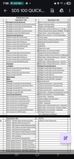

This is my favorites list / quick keys for West Michigan. Sites are always 0,10,20... And #1's are always interop, the #2's are fire.
This makes it very easy to switch between sites when Im doing fire photography in different counties.

Nice. But I was talking about on a scanner like the 996s or the 325/396.
