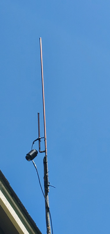

Two diy antennas that won't put you out of pocket
The J-pole
I built it for 2m/70cm , then on a whim I tuned it for 155mhz, works amazing, it is dedicated to my pro-2044
My first diy antenna, ended up being dedicated to airband scanning
