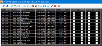

Are you saying the bandplan is populated on the bandplan tab in UT2 for you? Mine never has been.
Yeah. If you look at the top picture, that is how it natively populates. One reason that it may work for me is that I utilize the RadioReference Premium Subscriber features that allows me to download into Unitrunker 2.0. That is the fourth icon on the left with the little green arrow. That is a personal decision only you can make.
On the bottom, is my OCD coming in to play and I re-ordered the list numerically by hitting the Lo tab.

Just checked Whitby right now and it pops up just like Mississauga as in the top picture, immediately.
