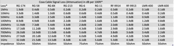

i used the cable loss calculator from Times Microwave and found that at these operating frequendies there would 4.87dB attenuation. I know I could use LMR400 or 600 but it would require jumper cables at the radio and antenna end that would induce losses as well.
