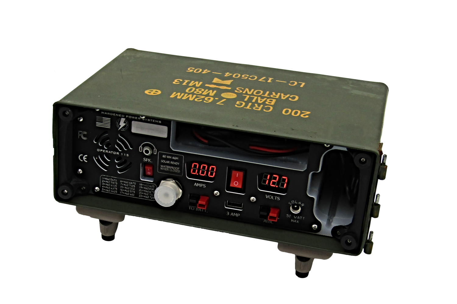

I have a Midland MXT115 (15 watt micromobile) mounted in a Hardened Power Systems Operator 115 (30 Cal ammo can) that I use for a base station. I’m running it on a GMRS tuned J-Pole antenna in my shop attic at about 20 feet and LMR-400 cable. I can easily hit North Georgia GMRS repeaters that are 20-30 miles away (repeaters are on mountain towers). It is a decent radio, but the cons are that it is narrow band only, you can’t run different PL tones for RX/TX (split-tones) and you’re limited to just the 8 repeater channels. A better base would be something like a Kenwood TK-880 (25 watt) or 880H (40 watt). They can be found used on EBay for less than $100, especially the 25 watt versions. You can obtain the programming software on eBay generally for around $20-$30 and you can program numerous groups, repeater channels and simplex channels, and all sorts of Fleetsync, signaling and tone settings, as well as separate CTCSS tones for RX/TX, and you can even program 70cm HAM frequencies to monitor. Here is a link to the Operator 115 Ammo Can radio mount/housing, and a short video of mine testing a simplex repeater (I made the custom cable).
For HTs, I have both the BTech GMRS V1 (I have an earlier example that is 5 watt high power and 2 watt low), and several Kenwood TK-380 Type 1 radios (commercial grade, 450-490MHz). The BTech works great and is easy to use and program (can program with the keypad or using Chirp software). The Kenwood TK-380 are my favorite though. They have the same features and programming software as the TK-880 mobiles I mentioned above. The Fleetsync features are cool...being able to send short status messages between radios, doing selective calls, etc. They are 4W high power and 1W low power, are narrow or high band, and have many features. The best are the Version 2.0 with the full DTMF. They can be found online generally for $50-$100 and audio performance is really good...very rugged radios (meet/exceed many MIL-SPECS). You have to be careful as there are three types (Type 1: 450-490MHz, Type 2: 470-512MHz, Type 3: 400-430MHz) and many Ebay listings don’t mention what type they are (obviously you need Type 1 for GMRS). The version 1 and version 2 have nothing to do with the type, just physical differences and added Fleetsync functions.
The good news is they’re all FCC Part 95 type accepted and legal for GMRS use. Just more info for you.
