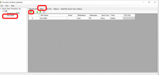

Creating the system is only the first step. You then need to create a site. After site is created, click its name in the tree navigator on the left-hand side and you'll see where to add the frequencies (click + sign for each frequency needed)
IMPORTANT: If you choose not to create a department with at least one talkgroup you'll have to go to the system level on the tree (named "test" in screenshot) and click the Options tab to turn on ID Search otherwise the system won't scan

Open the Favorites List Editor. Select he Department of interest and and display the channels.
Click on the green plus sign and it will add a blank row to the list of channels in which you can manually enter the information.
