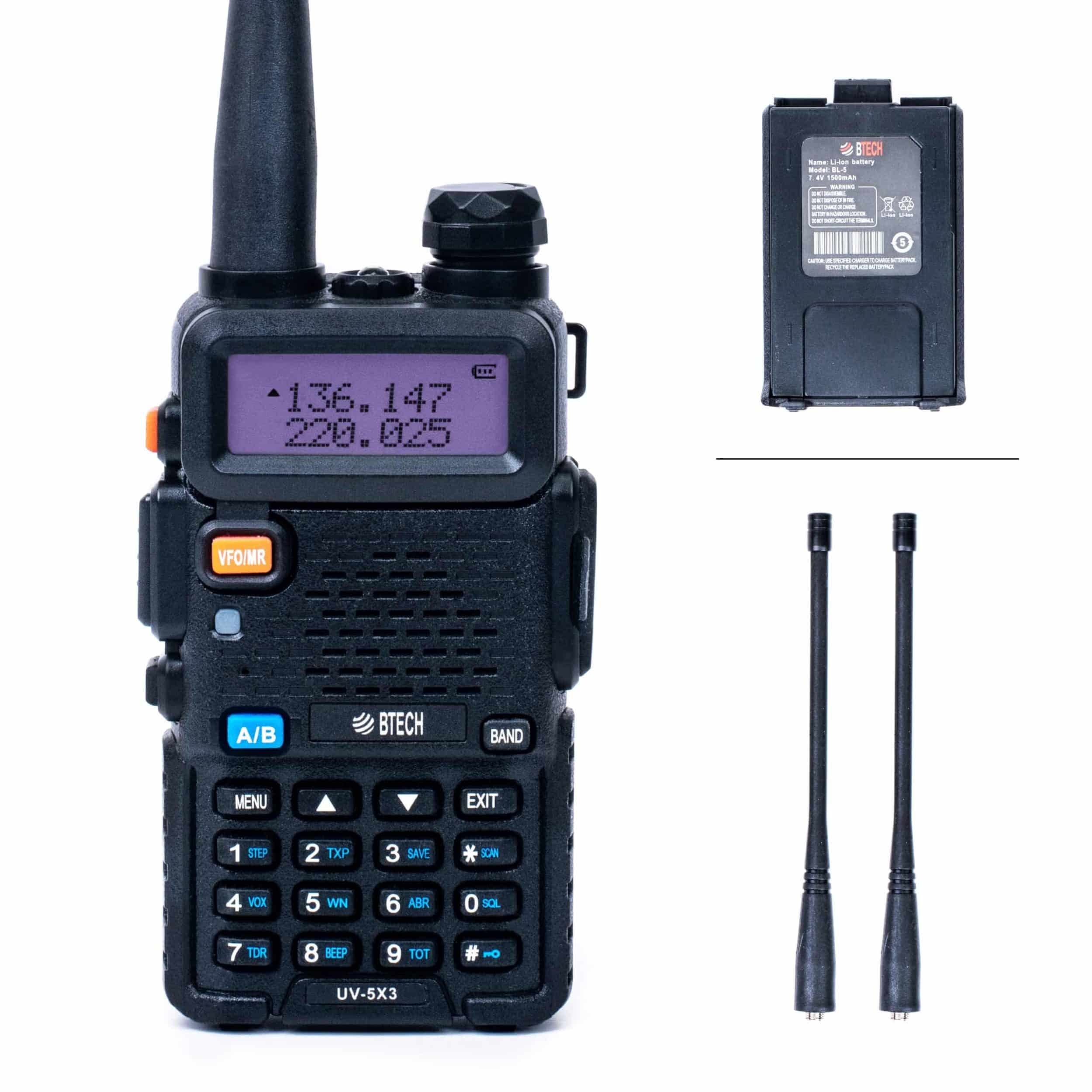

The UV 5x3 claims it's a Ham band only according to BaoFeng. 450MHZ - 470MHz does not have a ham band in there. UHF Ham band is 430MHz to 450MHz
BTECH UV-5X3 5 Watt Tri-Band Radio : VHF, 1.25M, UHF, Amateur (Ham), Includes Dual Band Antenna, 220 Antenna, Earpiece, Charger, and More Two-Way Radio
