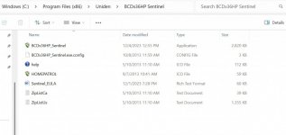

Can you please let me know how where to find the actual database to zip? When i look into the Uniden folder, all i see is program files. I don't actual see any database or stored preferences (favorite files names) please see the attached screenshot or do i just zip the entire Sentinel file as show in the attached screenshot
