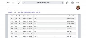

All four Washington County Law Dispatch talkgroups are full-time encrypted. You will not be able to receive them. Is that the issue?

You might double check down in your state (Utah) forum for input from someone in your area. But looking at the change history on the P25 Phase II system in use in your area, I see comments dated 6/9/25 (a little over 10 days ago) regarding updates to talkgroups associated with your county (Washington) including updates for encryption status on four talkgroups. So, the change to encryption may have been made fairly recently. You were able to hear them, I presume, up until they switched to full time encryption. On the old analog system, the county talkgroups were not tagged as encrypted. (looks like your query was moved down to your state forum after I first read it.)

Came up empty for me as well. But it appears that the addition of encryption on TGIDs relative to the OP's location is the root cause.
