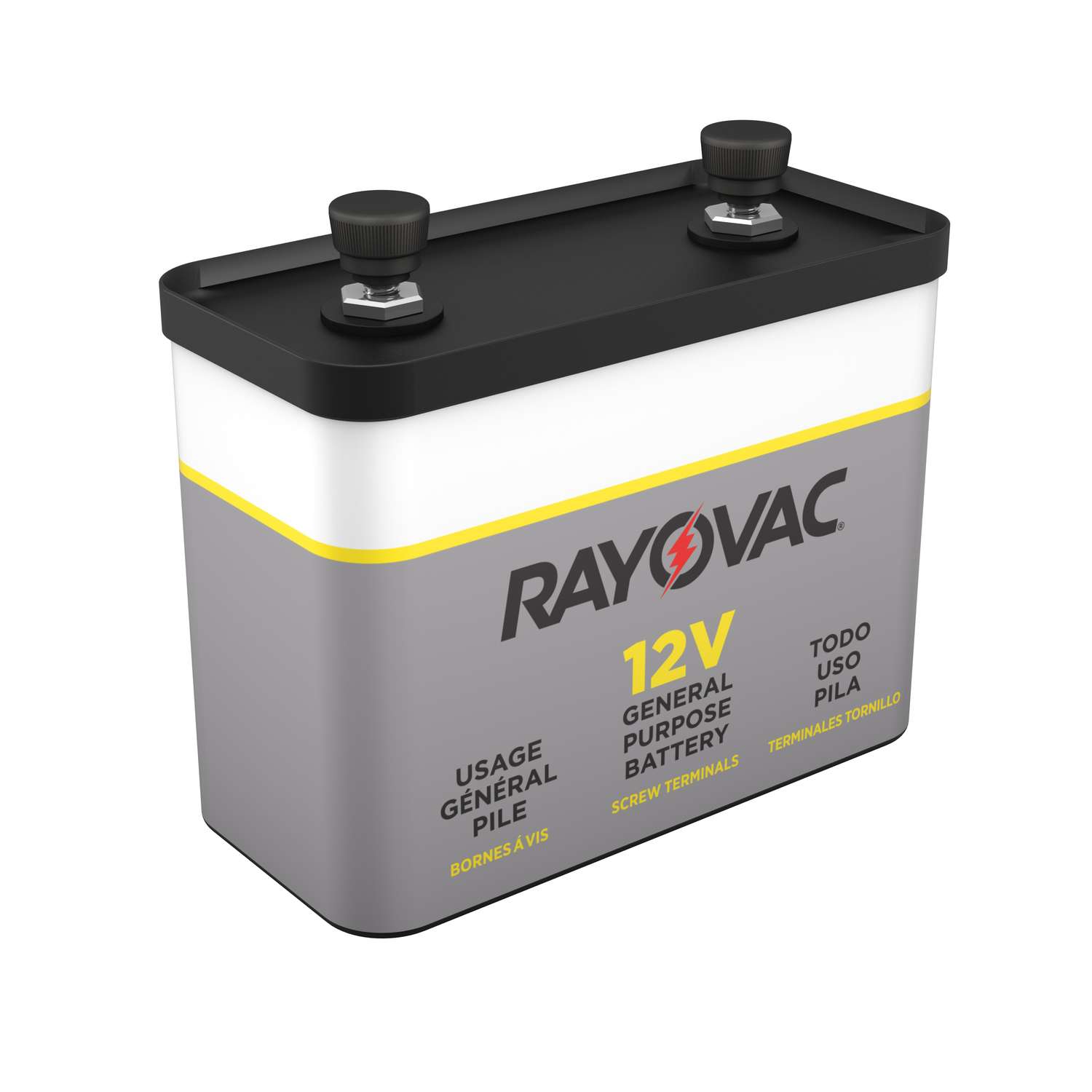

I do this with my BCT15x a bit too. I use 12v lantern batteries. They have decent shelf life so I also kept one in the closet for backup scanning power during monsoon blackouts.

Thanks for the suggestion! So this is a one and done kinda thing, non-rechargeable. I like the size and the price is good too. How much scanning do you get from one battery? Can I get 10 hrs out of it, maybe even power 2 radios at the same time?

Thanks for all those points. I'm leaning towards that lantern battery suggested earlier as it will easily last me the 2 days. I like your idea of testing the equipment beforehand. I can't really do that with the alkaline without using up some of the juice. Hopefully I don't get a dud. Anyway it's Amazon's deal day so I'm gonna look at all my options again as far as pricing goes.
