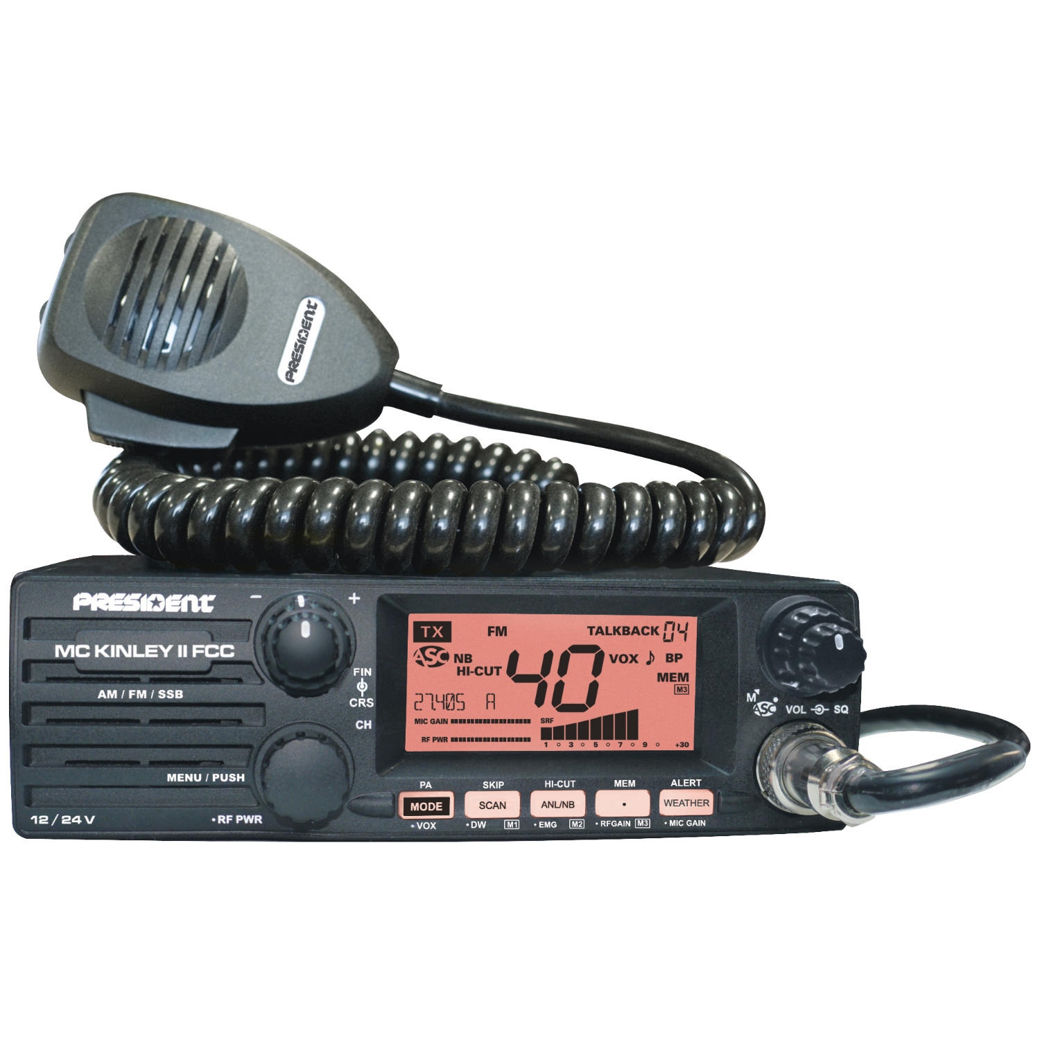

First, I’ll vote for the President McKinley II FCC:
Walcott Radio has it on-sale and free shipping. One unique thing about this radio is it has a front-firing speaker. Most radios have the speaker firing from the underside. With McKinley’s speaker on the front, you may not need a separate speaker.
So other than the front firing speaker, are there really any other attributes about this radio of why you would vote for it over anything else?
This truck I’d be putting it in actually has a pretty good remote speaker that’s on the side of the cab so, the fact that this radio has a speaker on front of it doesn’t really matter to me and besides, front firing or not, if it’s still the same quality speaker as what comes on the bottom of most other radios, I wouldn’t be interested in it for just where they put the speaker.
