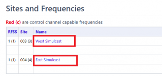

I believe I do have some multipath issues with some services, but it's hard to tell.
Go to the system in question's RRDB listing and click on your target site name's hyperlink as shown under "sites and frequencies". Scroll and find the site location map for a visual representation of where the sites on the simulcast cell are located. Pinpoint where you're located on said map. If you're situated between two or more sites on the simulcast cell then simulcast distortion will likely be an issue for you
