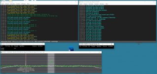

I have DSD+ Fastlane configured and to monitor the DMR T3 MRC Systems (L6), site 12 .
I am monitoring with a two RTL-SDR setup, with one dedicated as the CC controller ('CC Monitor'), and the second the voice controller ('VC Monitor').
The radioreference site resource indicates this to be a single frequency site with a channel number of 1405/1406. I have this in my frequencies file and I am managing to decode the CC and hear voice transmissions.
I am questioning...
1) The voice transmissions are coming through via the CC Monitor. The CC Channel Activity is handling the voice comms, while the enabled VC Channel Activity window remains inactive. The per call recordings are going to the CC folder, and not the VC as a result. Is this because there's only one frequency? If I monitor another site with the same configuration that has a few frequencies, monitoring behaves as anticipated with voice going to the VC monitor, and CC quietly decoding the CC. If this is the case, can I avoid the whole second VC configuration and just use the single RTL-SDR config to act in both CC and VC ('Combined CC/VC Monitor') capacity?
2) The CC Activity Window is displaying :
ChTx FreqPriTargetTgtAliasSourceSrcAlias
1405422.7875CC
8190
It is identifying a channel number (8190) but no corresponding frequency. Would this indicate that this site has another frequency associated with it that remains unidentified? RR only recognizes one frequency association with this site on channels 1405/1406
