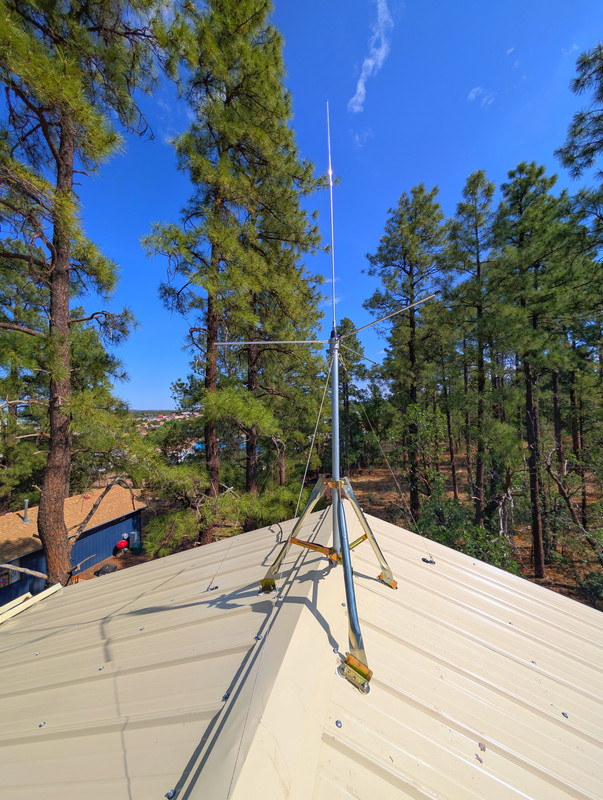

This is the Sirio GP =E3 that I tuned to 150mhz. It was quite sketch to get it up there. When I say slick, I mean that 4/12 pitch roof is scary slick. Even with grippy kneepads and gloves I could only get traction from digging my knees into the protruding screw heads. Not fun. It is held in place with a pair of strong neodymium on each foot, with a dab of adhesive on each magnet. The guy wires are "just in case". 8 months later it is holding up perfectly.

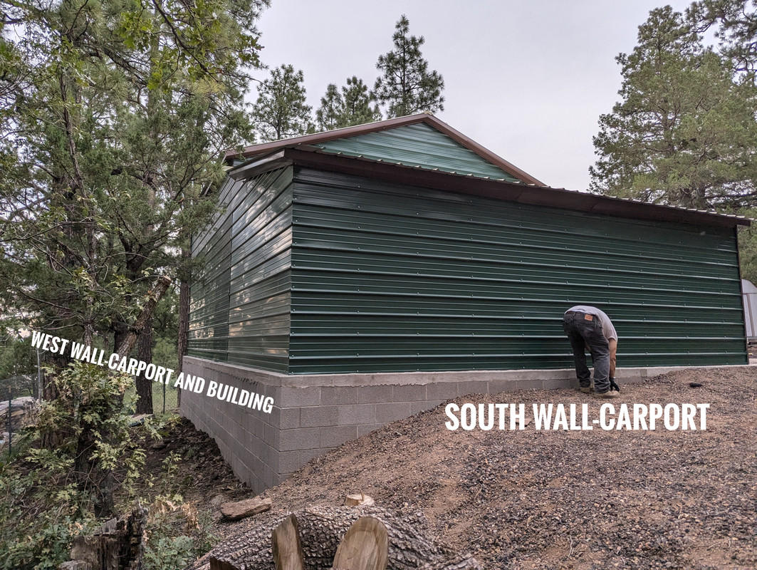

Of course, the only way to reach this area of the roof is from the opposite side. I promised myself to not go up there again short of some dire emergency. The "west" wall is the closest ground point up to where the antenna is, that corner is where my radio desk is. The shop site was sloped so it required a 5ft tall stem wall to bring that end up to grade. Total height from ground to roof is approximately 23ft. Even getting a ladder in that area is a challenge.
I'm all about magnets - anything to avoid drilling holes in the building. Ideally, I'd like to stick a shelf bracket to the west sidewall as high as I can reasonably reach, then attach a magnet mount antenna in the 450mhz range to it.
