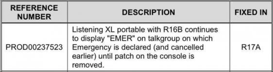

Is this occurning when the dispatcher is speaking? We had a simular issue, when on 2 of our talkgroups the radios would receive EMRG. It was a bug in the firmware that was corrected. It had to do with patching talkgroups that had a emergency declared and cleared.

Is this occurning when the dispatcher is speaking? We had a simular issue, when on 2 of our talkgroups the radios would receive EMRG. It was a bug in the firmware that was corrected. It had to do with patching talkgroups that had an emergency declared and cleared.
Our issue only occurs when Tx on a portable or mobile. The hospital base station clears the Emergency as soon as they Tx. Dispatch does not monitor or Tx on either of the channels which we are having these issues on.

Doesn’t do it with non Harris radios? Sounds like a Harris firmware issue
We had the same issue with a Tait system and Zetron consoles. The Harris radios were the only ones that generated phantom emergencies and couldn’t clear.
The dealer of the Harris radios had to work with Harris to figure it out and they loaded an updated firmware, and it’s been a non issue since.
