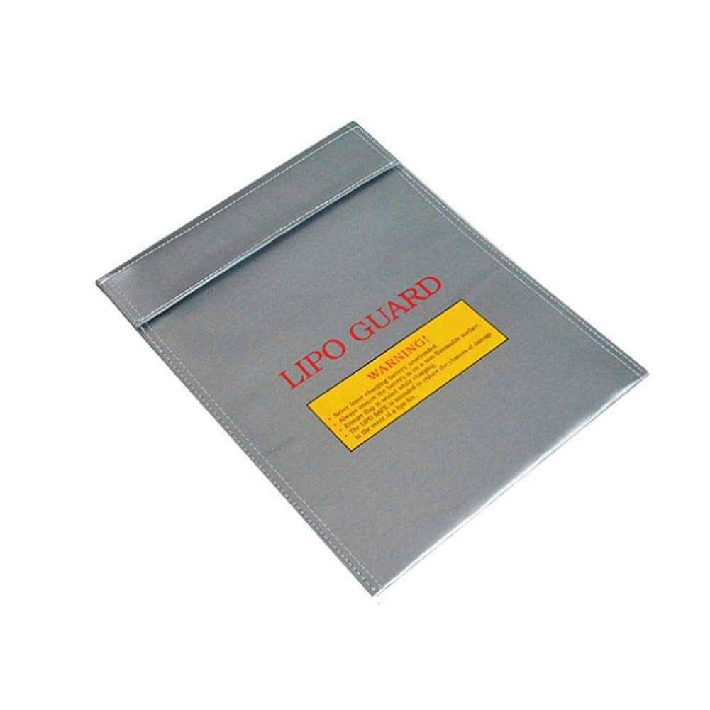

I always suggest getting some of the flameproof storage bags for lithium cells plus maybe a couple good old steel army ammo boxes.
Keep spare or unused cells in those containers plus keep the containers in an area where things can't combust from heat should they manage to go up in flames inside the storage devices.
I've only had one small lithium cell actually flare up with flames on it's own. I've had a few that did swell up way bigger than I'd ever imagined they could have.
I also had a lithium cell I purposely took apart slowly. As I unwrapped the layers of the cell, it suddenly burst into flames. Not simple flames either but very intense and really hot flames judging by the flame color.
I was able to extinguish that experiment with a halon extinguisher but as soon as fresh oxygen was allowed back into the box, the flames reignited immediately!
It is kind of scary when you think of all the lithium cells a typical active household may contain these days!
The main thing I guess is try and have some faith in technology as they are making them safer and safer as time goes by.
With the tons of cheap devices coming from China though, who knows what kind of research they may be doing to prevent fires from lithium technology.
Maybe instead of banning TikTok, they should look at tightening up restrictions on Lithium technology!
