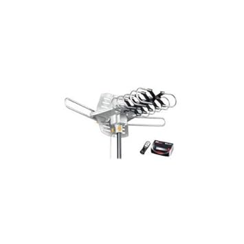

If a standard yagi wont work i was looking at one of these says it is capable of multipul output i already have a base thatll support it and mounting it vertical dont seem like it would be that hars

I built a corner reflector for 800MHZ and ran one length of RG6Q to a splitter inside the house where I use F to MCX adapters into two dongles. Locate the antenna in the proper position and direction and it receives pretty well. (I also found that a 300 to 75ohm balun and shielding the dongles in a metal case improved things as well) I've tried it with and without an amp, and tried the antenna in multiple locations. Living in the middle of a P25 simulcast system, it turns our that less is more. No amp and lowering the antenna improved reception in my case. I building an antenna isn't in your bag of tricks, you might look at some of the off the shelf, newer digital TV antennas. They're pretty small, built to approximately the right frequency range and can be pretty cheap. Just make sure that you orient it vertically.

I have all the other bands covered and the reason i was looking at a tv antenna is they cover all the p25 channles in my areas and my farthest out p25 simalcasts both come off of mica peak and i have issues with the 147.200 repeater right next to them on bad days instead of building my own yagi prebuilt is better
