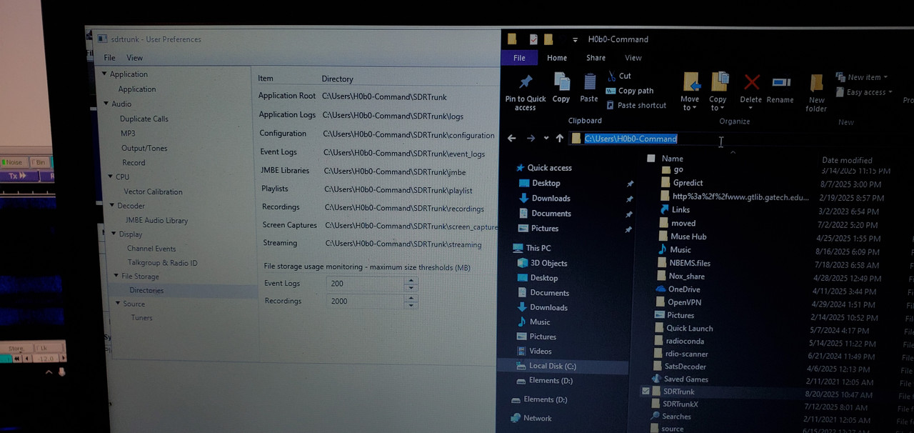

I'm not sure that will do it . Anyways go where the program is my case its User there should be two folders you want the one that just says SDR Trunk and grab that folder and drop it in the new location that whats works for me as I have two machines that I bounce back and forth
Uhg,
C\users\username
Don't know why I put appdata
