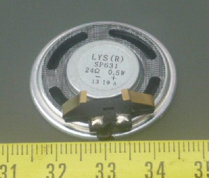

I believe that the SDS100 speaker has a plastic cone to maintain water resistance. That would explain the poor low frequency response.
Maybe, but my Standard Horizon HX40 is IPX7 rated, and on marine and NOAA channels it has superior sound to the SDS100. And the HX40 is quite small. For a marine handheld, I highly recommend it. According to it's size and the size of the speaker grill area, it suggests the internal speaker is no larger than the SDS100 speaker. I am wondering if the HX40 speaker will fit inside the SDS100. I have some investigating to do.

Took the front cover off of the SDS100 long enough to measure the speaker, but the way that thing is glued in, I don't think I want to remove it. I would have to use a hobby knife or scalpel to cut through the white RTV like adhesive. Don't think so, especially not knowing for sure which particular brand would sound better.
The speaker is 8 ohm 1 watt. Round, 36mm wide, 5mm thick.

In most of Unidens scanners they have a 24 ohm speaker, 0,8W in 436 and 0,5W in some others and seems to be 32mm in diameter.
The SDS100 uses a stereo amplifier and one channel are full frequency range but the other channel are frequency limited and are probably the signal that goes to the internal speaker to not overload it so easily if the signal instead where of a full bass frequency range.
But if it actually are a 1W speaker in SDS100 then the circuit could probably be modified to use the other full frequency range channel. I use both channels in parallel to power an external speaker.
