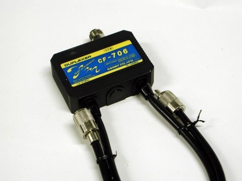

What is the cutoff point for the HF connector on the 8500 and will you monitor 6m? Here is one I have at home that passes from about 1Mhz to 57MHz on the low side then 75 to 550MHz on the high side, not missing anything in the VHF/UHF bands. I remember buying it used on eBay for about $50.

Thanks prcguy. Just wanted to be able to scan continuously without having to change coax connections between HF and UHF/VHF. The 8500 was to be my overall radio to go through the bands. Looks like will have to use separate cables for now. Got a recommendation for a diplexer?

The comex Duplexer works awesome. With my discone, can actually scan through all the bands now without issues. That worthless t connector I bought was junk and didn't work at all. Maybe there was a conflict of radio waves going into one feed that caused issues. I don't know. Couldn't listen to anything high or low with the T connector. This comet separates the two. No loss of signal using it. As for the discone and HF, I strung a 50 foot wire recently about 20 feet in the air. Compared the two and still get the same signal or better on my discone. Discone is about 35 feet in the air.
