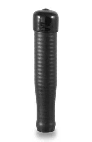

Has anyone tried a stubby antenna for P25 to help reduce simulcast signals that crush some scanners? Already have a 150 but the 160 I have suffers pretty bad in my area for P25. Have around 10 simulcast towers around me. I have a stubby antenna but wrong connector and not sure what frequencies it covers. In my radio parts bin. Could get an adapter but don’t want to waste money if it doesn’t help.

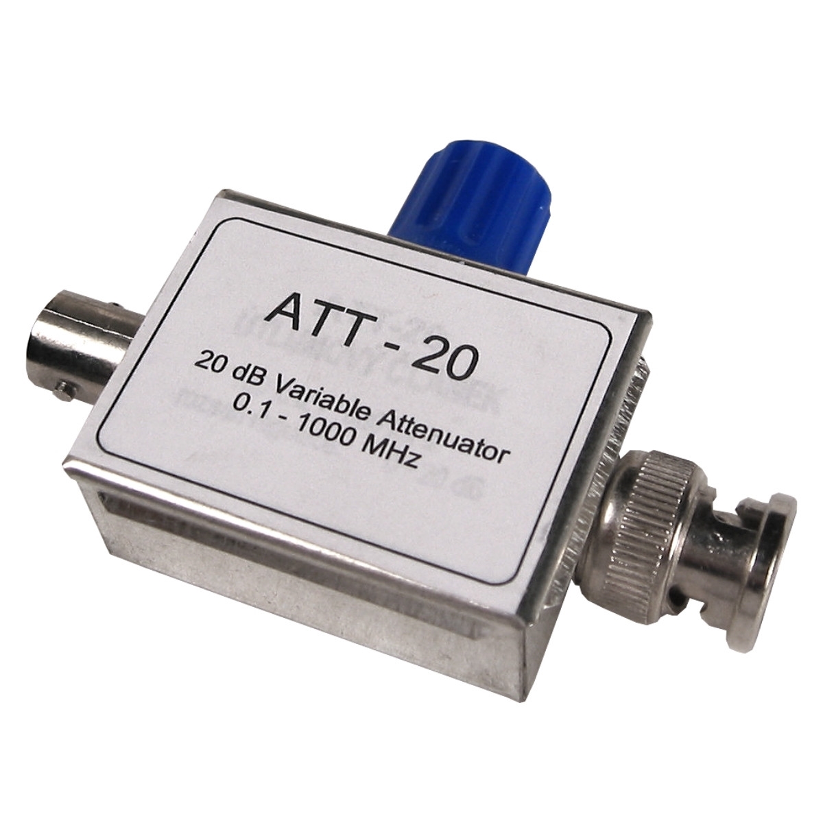

Hi @bearcatrp, you could try a paperclip 📎 on your Uniden BCD160DN to see if that makes any difference. Try different lengths too. The shorter the better in many cases. Also, don’t forget about the built-in software attenuator on your scanner. That could help. Like has already been said, moving the scanner a few inches to find the “sweet spot” might improve things too. Another trick to try is by changing the antenna polarization from vertical to horizontal (lay your scanner on its back).
In my case with the Uniden BCD536HP, I have achieved decent reception in a heavily simulcast environment by reducing the antenna gain by 20dB or so 😂 and finding that sweet spot. I simply use inline attenuation that can be easily removed when I want to receive non-simulcast systems.
If you don’t have any inline attenuators with BNC type connectors on-hand, some examples would be:
It is always fun to experiment with different methods in an attempt to overcome simulcast distortion…
<edit>
I just noticed that the Amazon link is NOT a set of attenuators (pictured) as I originally thought. It is for a single 20dB attenuator. Having a set of different values is helpful for experimentation. There are other attenuators on Amazon for $15 each. Shop around…
To be clear, 150 and 160 refer to these? smileyantenna.com
bearcatrp
Apr 11, 2005
4,179
2,156
Land of 10,000 taxes
Thats for 145-155 Mhz. Am looking for one that covers 700-900 Mhz. Saw a few online but going to try the other suggestion using a paper clip just for giggles to see what happens.
That VHF antenna would most likely work better than a 700-900 MHz tuned antenna. You want to attenuate, not amplify.
Avoid the Diamond RH3. When used with my BCD325P2, its performance is comparable to the stock antenna, so it's not what you're looking for.
I also tested the Gabil GRA-SCH32, which had noticeably lesser performance than the RH3, and costs under $20, but I'm guessing a paperclip is a better option at this point.

Does the Uniden BCD160DN have a numerical RSSI on the display? Or on your Uniden SDS150, what is the received signal level at that particular location? For the stock antenna and the paper clip to be the same, the received signals must be fairly strong. That is where attenuation is needed to knock down the received signals to the point that the scanner will “lock” onto the stronger signal of the bunch so the Uniden BCD160DN scanner has a chance to decode from a single site, if possible.
You may want to spend $13 to $20 for one set of following attenuators to see what knocking the signal down will do. Knowing what your numerical RSSI is at your location will help in determining just how much attenuation might need to be inserted to reduce the signal levels while keeping the strongest signal above the noise floor. Since Uniden does not publish specs for receiver sensitivity, we will have to make a WAG and start around -100dBm.
Let me know if you have any questions.
Pair of 15dB attenuators for about $13
Pair of 20dB attenuators for about $20
Pair of 30dB attenuators for about $20
NOTE: This is a test only and may or may not work depending on your received signal strengths.
