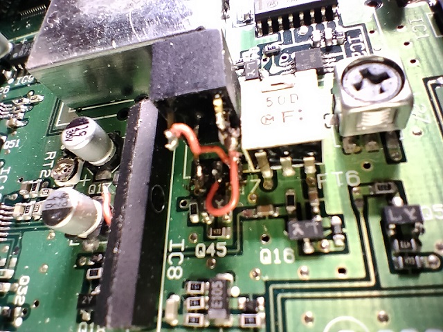

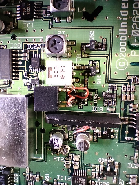

There are two amplifier transistors in 780 right after the bandpass filters and the second one can be modified without sacrificing any noticeable RF performance loss in sensitivity or NF noise level or even strong signal handling, it might even be improved. The operation level of the transistor are set at the lowest NF noise which is 1.1dB and at the higher amplification that the modification use it is 1.2dB, so nothing that should be noticed but the higher current thru the transistor probably makes it handle strong signals even better.
At its antenna connector are a metal screening box over the bandpass filter components and below that to the front of the scanner are another screening box and between the two boxes are the amplifier transistors. It's a 820 ohm SMD resistor that needs to have a 100 ohm resistor soldered on top of it. It's probably easier to use another SMD type than using a resistor with legs. My SMD resistor, the 101 one, where of a larger kind so I had to make sure it made contact by solder a blob to a capacitor going to the same point.
In the picture I have removed my screening box over the bandpass filter for another upcoming modification.
When doing this increased amplification mod the audio level at lower signal levels starts to increase somewhere at -90dBm -80dBm and stays constant over this RF level in my scanner and to correct this bump in audio I had to change how the AGC functions operate to make it work more aggressively by solder a jumper over a resistor that normally limits the AGC action. Maybe the bump in the AM audio level isn't noticed in normal use but if you have a thin enough solder tip it will be easy enough to do the mod. I used a blank wire soldered over the 103 resistor.
/Ubbe
