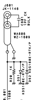

My guess are that the original owner used another type of antenna connector that needed the studs of the scanners BNC connector to be removed, maybe a TNC connector. Uniden might have the micro MCX connector with coax and BNC as a replacement. It might have damaged the center pin connection so look straight into the BNC conenctor and take a picture as well.
Tune the scanner to your local FM broadcast station, Channel+Frequency+Channel and do the suggested test to pull the coax from the circuit board and touch a wire or paperclip to the MCX connectors middle pin with squelch open to hear the noise and it should be some sort of reception. In Sentinel do "Clear User Data" on the SD card to restore all settings to default.

You mean the center pin of the connector that is soldered to the circuit board? If I do that with a paper clip on a local channel will it show reception bars in the display?
Yes, that is correct. If you see signal bars, the receiver is working and the problem is with the BNC connector assembly.

Tested the antenna connection bnc to connector to board. Center conductor OK and ground OK. nothing seems comprimised

Why are you showing the back of the scanner. You unplug the antenna connection inside the scanner and touch the clip to the center of the connector soldered on the circuit board inside the scanner.
Because a previous member asked for a pic of the BNC on the back of the unit. I unplugged the cable and tried center conductor with a paper clip on local channel that was active on my other scanner. Nothing received

Did you check for a short between the center conductor and ground?
1000 ohms center to ground when the rear BNC when it is connected to the main board. When I had the connector off the board there was no continuity between center & ground
That checks out to be fine. As most of the front end components are covered in epoxy it needs to go to Uniden and they will swap out the whole board as it probably costs them $50 and spending time on it to do fault tracing costs a lot more.
