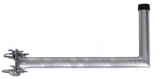

Oh thank you so much! Any recommendations on particular hardware/mounting arm or where to get them from?
Places that sell TV antennas usually have masts and mounting stuff. Maybe shipping costs are acceptable on Ebay and Amazon.
