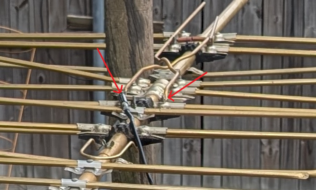

I got this old VHF TV antenna, and I assume it uses a 300-ohm twin lead cable, but does the cable attach to the antenna?

Often there's a pair of wing nuts that the 300Ω twin lead would connect to.
Installation would often use a 300Ω to 75Ω balun to covert from the twin lead to coax:

Looks like a dual band antenna, low VHF and high VHF and the active elements are the ones with plastic insulators. It should probably be a plastic box attached to those two pins at the top, for 200MHz VHF high, that ends nowhere and where the coax should go. The low dipole with the U metal piece are probably the 60MHz low VHF that should probably have a coax that then goes to the diplexer filter box to combine both antenna sections to one coax. As parts seems top be missing it could be some issues trying to use the antenna.

That makes sense. Can the missing part be purchased or constructed? The antenna is around 10 feet long (two smaller sections that connect together). I'm wondering whether the antenna is worth saving or not. I would rather not discard it if it has any use. Many channels are UHF now, but I think a VHF antenna also picks up FM stations.

Here is a picture of the entire antenna. There are four of the small U-shaped antennae on the VHF low end. I don't know if these should be connected in some way. I will try to connect to the larger piece that crosses like an open figure-8 and see if I get any signal.

For anyone that may be interested, I found that if I connect the antenna to the two wingnuts shown in the image, I get a very good signal.

I don't have a VNA to really test what it receives, I just meant when hooked to a TV I'm getting many stations just mounted on a pole 4-foot off of the ground. Do you think the frequencies are limited by not connecting the U-shaped pieces? I may have to get a VNA and experiment with that.

Yes Ubbe, it appears to be a Winegard Colortron Model C-43, as shown in November issue Radio electronics magazine (bottom of page).

So it's missing that coax cable transformer box, or the additional amplifier. That box attaches to a pair of wingnuts, so if the antennas only wingnuts are used for a 300/75 transformer then it should operate as intended.
