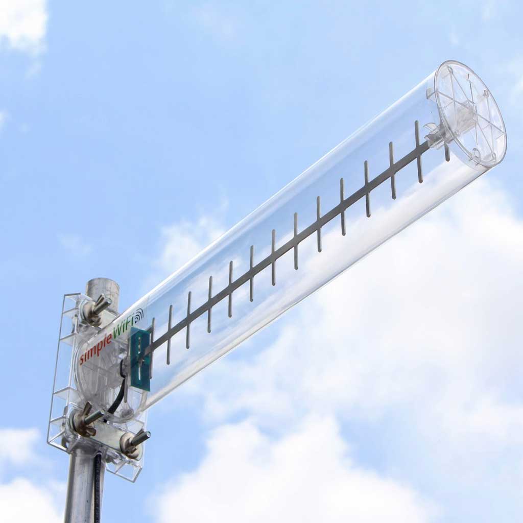

WIFI is not needed to use an sdr.
There are many options to get Wifi in the cave.
You could use a long range wifi extender.
If you can run a LAN cable out there you could use a wifi repeater
You could run a yagi of your home wifi
