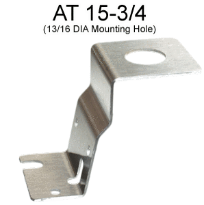

Thank you sir. I wish I could get some pictures to work, I’d like to know what I have regardless, so I know what it can and can’t do. I may just end up buying a new antenna, but if I can us what I have, I will. Do you know of a cowl NMO mount for a 2009 Nissan Titan? I’ve searched but haven’t been able to find anything that will work.

I really wish I could find somebody stateside with these brackets. Freewaycom won’t ship to me, and Albertaradiosupply will ship but it nearly doubles the cost lol.

You can try the antenna farm. They might have something that will work. You can also do a lip mount on the back side of the hood. That gets done on jeeps a lot.
They have one for the frontier and the rouge of all things, but nothing titan specific. I have a lip mount that came with the antenna, I may try that. It needs a new connector on the end of the coax though.
I’m considering just biting the bullet and punching the hole in the roof.
