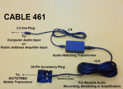

Cable 461 Audio Recording & Streaming Adaptor Motorola MOTOTRBO XPR4500 XPR4550
Here is what you are looking for. I have ordered many cable assemblies from this seller. All have been excellent.
This is exactly what I was looking for. I went ahead and ordered the "last" one, hopefully they re-stock fairly soon because I'll need a 2nd :ROFLMAO:
I'll let you know how it works, thanks again!

Thought I'd update you, received the cable yesterday, provides crystal clear audio to my PC. Thanks again for the recommendation!
