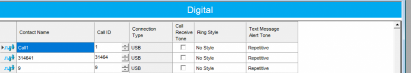

When I key my mobile I see the S-Meter I know the repeater hears me, I can see the S-Meter full scale hang time. I also went on the BM dashboard and cane see my MANY test connections to both TG9 and TG 314641 on the repeater. THE PROBLEM IS for some reason my audio is not coming through, I can not hear myself on the HT. Now if I send my wife outside to the front porch (afraid of desense not letting me hear it) and she calls me on either TG I can hear it. I have done countless tests when changing settings I THINK but not 100% in one case she was able to hear me but I was not able to hear her responding. Does anyone have any clue as what I can be doing wrong ? I am going to go over to my laptop and take a screen capture of the CPS and post as a comment but honestly is there ANYTHING else necessary than CC TS and TG (of course frequency) in a channel setting to get a Motorola DMR radio to fully function on a repeater ?

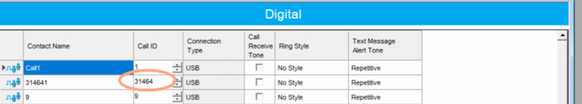

You are correct but the other channel was also not working, the TG was 9 and that was correct. 9 is local while 314641 is the one set up to be linked to BM so others with hot spots can check into the repeater. If users want to be "local" only they use 9 if they want to be able to communicate with others on hot spots they use 314641. Honestly MOST people use 314641 since it does the same as TG9 AND allows others to join in that may be out of range, out of state.. or yes... on a cruise ship with a HS on WiFi LOL.
Bottom line like I had told Greg last night it was very odd. One evening I turned the radio on and heard people, low and behold it was working! So IDK.... but now that I have a better handle on it all I am going to start a codeplug from scratch and not modify the one that was in there from the NYC area. Bought the rig at a hamfest and the seller was from out of town.

Greg I reallllly appreciate all the help and effort you have put in here and via e-mail thank you for all your support it was very helpful! The mystery of why it was not working at first (TG9) will continue but that may be due to Group lists, the fat finger was totally on me for the other TG. To my credit though.... using a Panasonic Tough Book and not a desktop monitor has been troublesome. It's in great shape, got it at the hamfest also just for radio stuff so I can leave my wife's Dell laptop alone and it has a REAL serial port but the screen is a bit small for my aging eyes. Also it seems that Motorola software engineers leave a lot to be desired. When CPS boots up the FONT just goes really small and the program window get's smaller. I got to look into that a bit more but it's so small I need to put my readers on and shove my face into the screen, that's probably why that "1" was missing!
