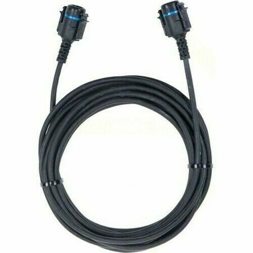

I buy the XTL 2500-100watts but my confusion is which Remote face. I am little familiar with this radios because I got 2–50 watts.
M21QTM9W1AN ( this is the model)
I not want to buy the wrong remote face mount.
Thank you guys.

Does the OP have a remote mount brick and needs a remote head with chib and cables, or is he trying to make a remote mount radio into an under dash type? The 05 head is nearly identical to a 2500 head but it will not work on a 2500 without modification. If the OP needs an entire head he should look for one that says 2500 in the upper right corner. The head pictured in post #4 would be correct.
If you are changing from a remote mount to an under dash or the other way around, the flex cable that connects the control head to the remote mount CHIB or to the radio brick are different. The remote mount flex is easy to find but the under dash type is not. I'm actually looking for another under dash flex with no luck in the last month. If you are going from a remote mount to an under dash there is also a plastic spacer that goes between the brick and head that is also hard to find.

Thank you so much. I just buy the 100w brick and I don’t want buy the wrong face mount…

its 100W I doubt he wants to make it an under dash
