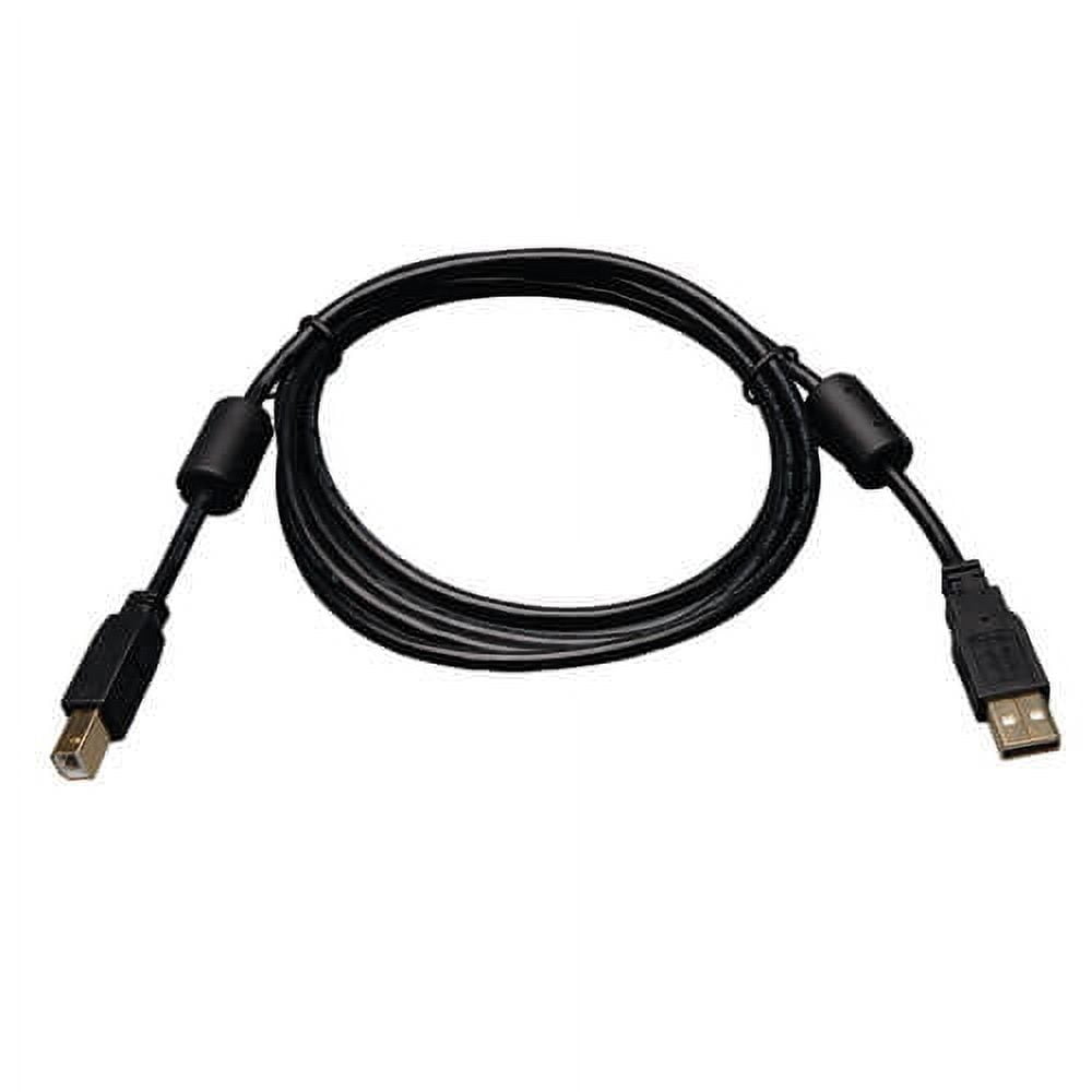

You can purchase the SDRplay RSP1A with free shipping from Ham Radio Outlet. If you find another vendor, make sure you are buying the RSP1A (not the older RSP1). And avoid that Chinese knockoff copy of the RSP1. Purchase the genuine version of the RSP1A.
I don't believe the USB cable comes with the RSP1A. You will need a USB-B to USB-A cable. I recommend you purchase a cable with the built-in ferrite chokes.
Thanks, @KB2GOM I just ordered the cable & RSP1A from the links you posted. By buying from HRO instead of SDRPlay direct, I saved roughly $15.00 on the RSP1 more than enough to pay for the cable. ;)
