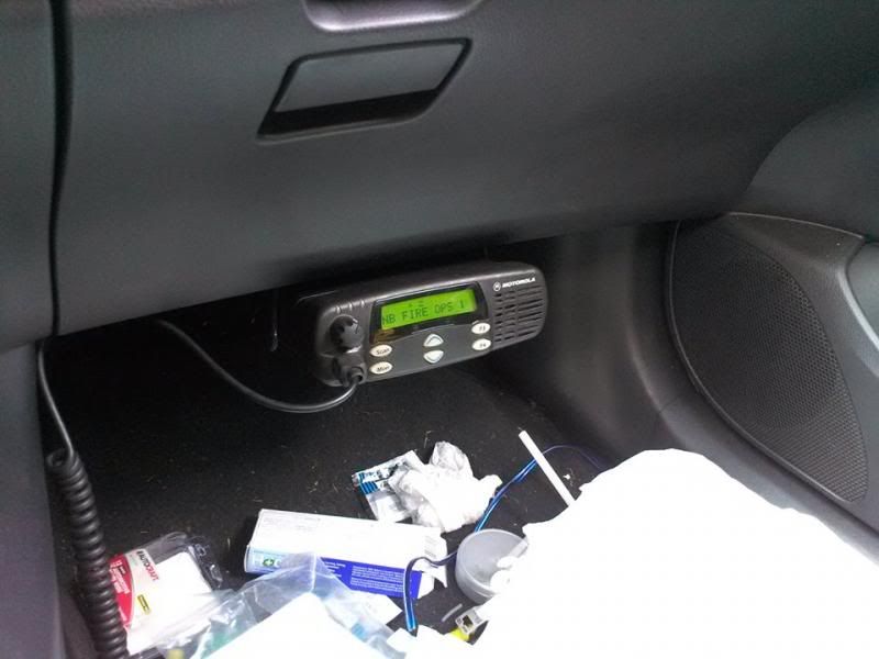

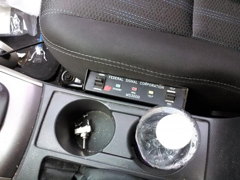

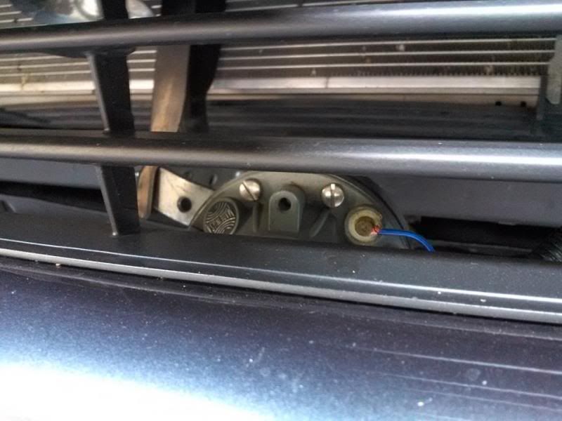

New work!
Today, I installed audible warning in preparation for a red-light package, and a radio.
Started with a main power switch.
Added a Federal Signal MS3000 100w siren. It's old, but it works and is compact.
I made a low-profile speaker out of an old Whelen Edge 100w driver and mounted it behind the bumper.
Added a Wolo 416 Euro hi/lo air horn siren system.
And topped it all off with a CDM1250 VHF.
