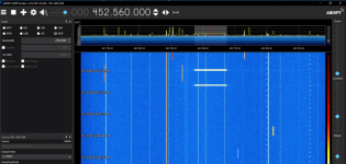

Any idea what this burst is? it repeats at various rates, at least once per minute, upto 10ish per minute. signal is from a Yagi in Norton Shores facing E/SE1763077280414.png

Well I figured it out. its harmonics from my Meshtastic node approximately 15 feet away, lol. the LoRa TX is ~906MHz
