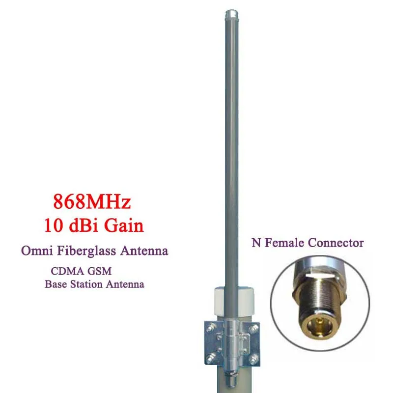

Can anyone tell me if this product will do the same job?
Sorry for the unprofessional question but high dbi increases the absorption intensity?
Note that is an 868–915 MHz antenna, not 851–869, so you would want one for the lower range.
DBi and dBd are two scales for measuring the receive and transmit gain of an antenna. 10dBi and 7.85dBd are the same gain.
BB
To explain, dB is a measure of one thing in relation to another. In the case of antenna gain, there's the idea of an isotropic antenna, which is a hypothetical radiator with the same radiation in all directions. dBi gives you the theoretical gain (or loss) relative to that theoretical radiator.
A dipole is considered to have 2.15 dBi gain (2.15 dB over the isotropic antenna). dBd gives the gain over a dipole. If you add 2.15 dB to a dBd value, you get the equivalent dBi value. So, antenna manufacturers may be naturally inclined to publish dBi numbers because they are larger, and theoretical. :)
The more dB gain the antenna has, the better you will receive or transmit some signals, but it usually comes at a cost of something:
  • Bandwidth – the frequency range over which the antenna gives that amount of gain. The higher the gain, the narrower the bandwidth is usually. Getting just the 850–870 MHz LMR base station frequencies should be fine with most antennas, though.
  • Vertical beamwidth – higher gain antennas tend to "squeeze" more signal toward the horizon, which is usually a good thing.
  • Directionality – directional (non-omnidirectional) antennas "squeeze" more signal into a "main lobe" (the direction in which they are pointed) at the expense of less signal in other directions. The higher the gain, the narrower in azimuth that "main lobe" will be.
