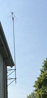

Yes - Chain-link fencing top rail sections make excellent antenna masts. They are typically galvanized,10'6" long, with one end swaged to fit into another section. Available at most big-box home stores.
I've been using a 15' top rail fence as a post for many years
