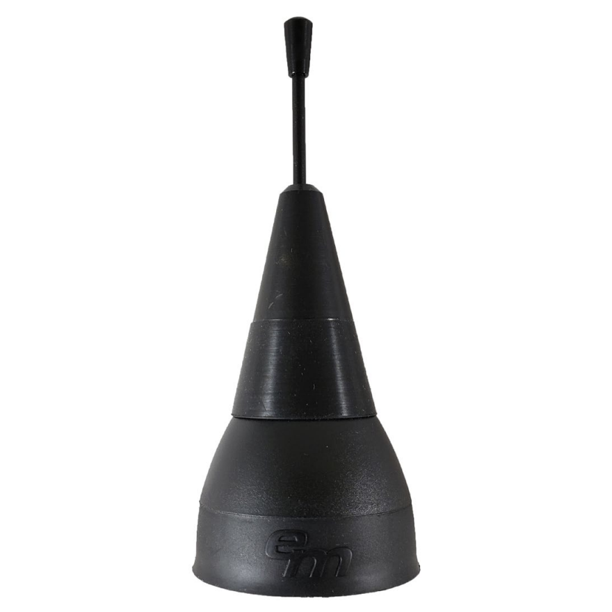

If all you want is 800 & 900 MHz, this antenna:

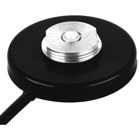

This mount:
Stick it on a metal pan, piece of sheet metal, etc. at least 12" in diameter to act as the ground plane when using it in your home.
You can put that on the roof of your car if you want to go mobile.

800/900 antenna - Using this at home is best. I would not trust that magnet mount while mobile with such a large antenna. As previously noted, put some metal beneath it for a ground plane and improve RX.

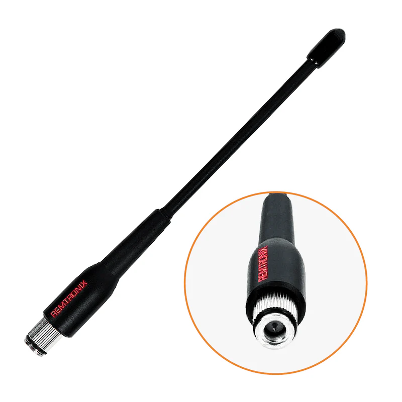

UPDATE:
I just re-read the OP and see the “portable“ request. Perhaps this Remtronix would be suitable.
