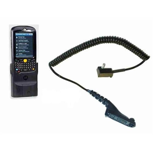

Hello,
I got an apx900 radio and I would like to use KVL 4000 for keyloading.
Which cable that I need to use it? It works at USB loading mode.
Should I buy this?
Thanks.

Plug the programming cable into the USB port on the KVL secure adapter….

Um…. The APX900 does not support hardware keyloading, it’s software only…
Are you positive about that?
Correct. Under “Encryption Keying” it specifies “Key Loader”.
Pretty sure software in this case means it doesn’t have a MACE (or any HW device for encryption).
Ouch. Kevin is correct, of course.
"Software AES" as pertains to the APX series = no dedicated MACE, rather the encryption functions are handled by the radio's CPU through software functionality, no different than how software ADP works in any other MSI subscriber. Keyloading for AES, however, is always done via a KVL or equivalent hardware (exception being KFDTool software in DLI mode); there is nowhere within CPS to enter an AES key into the codeplug.
  • The APX 900 has two Secure Operation options: Disabled, or Software
  • The APX 900 Keyloading Source forces the selection to KVL when AES is selected; only ADP by itself allows for the selection of Encryption Key List (i.e. entering the ADP key directly into CPS).
Source: firsthand experience with AES in the APX 900, not gleaning "knowledge" by reading a spec sheet :whistle:

So the correct answer was the programming cable into KVL?
Learn something new every day... The APX900 really is a different beast
jthorpe
Nov 25, 2003
391
191
Yes, if you're putting an AES key in the radio you need a KVL and the proper cable.
