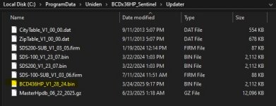

Sentinel will write the .Bin file to the "Firmware" folder on the SD card and also write it here... See below...
This is what I show for the Bin file size...

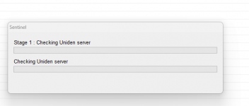

After formatting the card (I used a spare blank card that I had available)m I set the target model, in Sentinel, to the initial configuration for the x36HP (BCDx36HP), then did the 'clear user data' from the drop-down Scanner menu in Sentinel.
I then selected 'update firmware' in Sentinel, and (first try) got this screen:

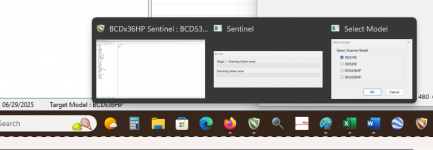

You actually need a third screen where you can select the model. If you hover your mouse over Sentinel's icon on the task bar, you see this:
Click on the far right example so that you end up with this:
(When I tried this a second time, it did go, directly to the correct selection screen. When I try it more than once, about 50% of the time, I get the first incorrect selection screen shown above. Just be sure that you do have the correct one selected. (I presume you do, but since this is such an unusual scenario, I mentioned it again.)
Note that even though my 'target model' in Sentinel was set for the x36HP series scanner, Sentinel defaults to suggesting the firmware for the SDS100. However, if you use that screen & select the correct model, that will be the firmware file downloaded.

I copied a firmware file for the 436HP to my One Drive account. (It's too large to be directly attached to a post.) You can find it here and download it. Extract (unzip) the file so that you end up with just the firmware file, which can be copied into the Firmware folder on your SD card, Then you can follow the instructions just above on how to update the firmware.
That is a known good file, and was used to update both of my 436HP scanners. If you, again, get the checksum error message, I'm out of suggestions. Maybe you will get a helpful response directly from Uniden.

Glad it's worked for you. This was the first time (that I remember) dealing with the sort of issue you were seeing. You were doing the right steps, but something (which, so far, we have not been able to find) was causing your issue.
Once you have installed the file, the firmware file is deleted from the scanner's SD card. Sentinel parks the file in a file folder under "Program Data" on your hard drive. C:\ProgramData\Uniden\BCDx36HP_Sentinel\Updater
The next time (if there is one) that you do a firmware update, the newly installed file will be copied to that folder, and the previous (installed version) file will be deleted. I've made it a point to collect copies of the firmware files and place them in a different folder. So, I have previous files for earlier updates for my x36HP & SDS series scanners.
