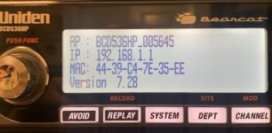

I am trying to get my BCD536 to work with my Siren WiFi Dongle on my iPhone 10X as I have in the past.
As far as I can determine, the dongle is not broadcasting in WiFi mode.
The BCD536 WiFi Info shows an IP of 192.168.1.1 when set in Access Point Mode.
I used the FING App on my iPhone to scan nearby WiFi IPs, and 192.168.1.1 does not show up, nor does the Siren App work on the phone.
Any Ideas?

With access point mode you are creating a separate network with the 536 as the AP, not your home network router. You need to use infrastructure mode if you want to see the 536 show up on your home network. If you want to connect the iPhone to your 536 (just these two on a separate network), then you can use access point mode and connect your iPhone to network BCD536HP_005645.

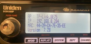

Thanks to all who have replied. I've tried your suggestions so far (all in Infrastructure Mode), except for driving to Walmart. I believe that the dongle is connected to my TP-Link_6E75 router, but that the router doesn't see the dongle, according to the router's WiFi client list. Check the attached JPGs, and tell me if I'm wrong
bcd536hp-wifi-info-jpg.188028
In this screenshot the scanner is in Access Point mode. It should come up as an available network on your phone to be joined. On your phone you'd choose the BCD536HP_005645 wifi from your list of available networks then input the passkey if you set one on the scanner during wifi setup. The phone should then connect to the scanner. You'd then launch the Siren app then enter 192.168.1.1 as IP. This mode is suitable if you're controlling the scanner out of range of a wifi router.

Thank you, Whiskey3JMC[/SIZE][/USER]. It works!!!! I forgot all about connecting my phone to the scanner's SSID

It's still a mystery why it connects to the TP-link router and get assigned the 192.168.0.204 IP number but doesn't show up in the routers list of connected devices.
The comment "I used the FING App on my iPhone to scan nearby WiFi IPs, and 192.168.1.1 does not show up" are probably only to scan for IP's in the home network and not for other WiFi routers that should be the name BCD536HP_xxxxxxx for the scanners access point.

I switched to Infrastructure mode, and Siren works now. Here are the instructions I wrote:
