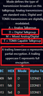

RMason
Sep 18, 2003
866
Colorado / Mississippi
From: Database_Administrator_Handbook_Live_Version
Talkgroup Mode​
  • A – Analog (may be voice or data)
  • D – FDMA digital voice
  • M – Mixed (analog voice and digital voice)
  • T – TDMA digital voice capable
Encryption modes shall be used to indicate talkgroups that use encryption exclusively or when encryption is partially used.
  • E – Capital "E" - encryption exclusively noted
  • e – Lowercase "e" - partial encryption noted.
Example Uses:
  • Te - TDMA capable talkgroup with partial encryption
  • AE - Analog with exclusive encryption
  • DE - FDMA digital with exclusive encryption
  • De - FDMA digital with partial encryption
Of course, this depends on the information in the database being accurate and up-to-date.
