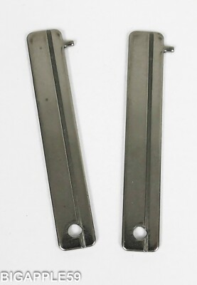

Get a couple of small Phillips screwdrivers or any small steel rod, and grind off the tips, bend the last 1/4" 90 degrees and it's easy to just lever them out. The tool is on Ebay, if you want to go legit:
