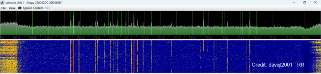

I have been monitoring a P25 Phase II LSM 700MHZ system for a few years now with a Airspy R2 with no issues. The system is in the range of 769-774 MHZ. Recently a new cell tower was installed very close to my house (1000 feet). I’m now having problems with audio distortion ever since the new tower was turned on. I have played around with the gain with no luck. I’m using the latest version of SDR Trunk 0.6.1 final with my gain set at 15. My power receive level is within the range of 45dB-60dB and the control channel holds sold with no loss. Any recommendations or types of filters would be greatly appreciated. Thanks

LTE / cellular interference will be wideband aka 5-10 MHz per channel just below the talk-out frequencies for the 700 MHz public safety band (Band 14). Ironically it's FirstNet. A filter would need to block below 769 MHz as it is not a specific frequency. There is a band of uplink frequencies just above 775 MHz, but that would come from subscribers aka low power and unlikely to affect you.

Might be interesting to see what it looks like if you zoomed in on the 769-774 area you mentioned
WB5UOM
Sep 5, 2022
719
569
Is any of that what you are trying to monitor?

IDK, lots of usable signals in the slice of spectrum.

When I increase the gain, the distortion gets worse.
Which makes sense. But as I said, lots of usable signals in that waterfall shot that should not require boosting gain, but you'll have to be specific about what system/frequencies you are having trouble receiving.

Both make sense. They are classic symptoms of Desensitization (AKA Desense) from a strong signal on another frequency that causes fundamental overload and spurious signals (spurs) that damage the weaker signals you are trying to receive. The spurs raise the noise floor, which reduces the SNR of the weaker signals.
Desensitization (telecommunications) - Wikipedia
Boosting the gain can't repair the damaged weaker signals.
Dave did specify system/frequencies in his first post
I suggested to Dave that he use the Spectrum Spy software that is available for his R2. It acts as a substitute spectrum analyzer at much less cost than a real SA. He said that he had done something "similar" with the P25 software that didn't help. Finally, after a request from @WB5UOM, Dave posted a scan:
Well, it is "similar," but it doesn't show a possible strong signal on another frequency that might be causing interference, only his received signals. Also the freqs are difficult to read and there are no horizontal lines indicating relative strength.
So, I think it is entirely possible that a strong signal below 769 MHz or the new cell tower are causing interference. But, that isn't sufficient information to order the correct custom filter. I would want to verify what signal is causing the interference with further scans and tests with a battery operated laptop and portable antenna at other locations as suggested by @wpt in post #11. Like, what frequencies are being used by the new cell tower?
