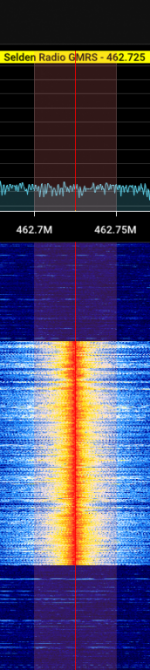

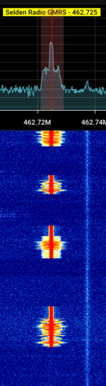

in 24hrs I havent seen anything from the Fire House on that frequency and coming back today to test I caught a 12:12pm announcement. 1754237622658.png

Is 462.725 a shared frequency ?
This issue intrigued me.. so I set up a few Software Defined Radios to sit on some of this spectrum...
The 462.725 frequency (or very very close to it) had people discussing parking vehicles, not enough space for vehicles and a bunch of a "Base to <Name>" transmissions.
That all seemed odd to me.

I do not hear that many - I just find it interesting that the focus is on Centereach FD however in 48hrs I cannot hear anything of FD on that frequency however I am hearing the GMRS discussion and then back today - I hear this business on it...
